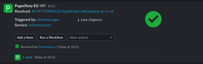

Triggered by field on slack notification
In Slack notifications which are created due to incidents from things like Cloudwatch and Prometheus Alert Manager there is a Triggered by field which links through to the source, how do I set this on notifications generated by the Events API? I have set a link in links but that doesn’t show and I can’t find any additional information on this

Really? I got it working with client and client_url outside of payload, shown in the example here https://developer.pagerduty.com/docs/ZG9jOjExMDI5NTgx-send-an-alert-event although not mentioned anywhere else on the page
You are correct @stephen. For some strange reason, I probably documented the tests I performed earlier poorly. I’ve ran the tests and you I can confirm the triggered by field shows up when I send client and client_url outside of payload.

@tiago.barbosa I noticed yesterday that the Slack notifications changed, the big icon on the right hand side is gone and there is now a little circle next to the name of the alert… fair enough
but the “Triggered by” is gone as well and there is just “via XYZ” at the bottom but that does not link through to the client_url, that is a huge step back in usability
Thanks for reporting it @stephen. I still see the ‘Triggered by’ message in the bottom. But the link points to the integration defined on the service, not the actual source of the event (Postman in my case).
In order to navigate to the client url you would need to open the incident, scroll down to the alert and click on the client link.

Thanks, I understand that you can still find the link within PagerDuty but it’s now an extra click, having to log in and scrolling to get to the information, which just slows things down
I see the link was re-added last Friday, thanks for that!
